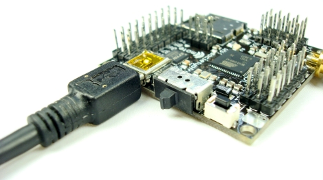

    If you have Windows, simply plug in your Axon Mote by USB to install the USB drivers. Windows will automagically detect the new hardware, so just follow the Windows prompts.
    note: The version of drivers that comes with Windows is out of date and very buggy. It is strongly recommended you upgrade your FTDI USB drivers, especially if you experience problems.
    STEP 2: Connect Power

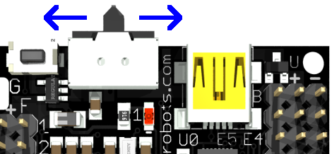

    The Axon Mote can be powered directly from USB. The power switch is an On/Off/On type, so it is off when in the center. The Mote knows whether the switch is Left or Right, letting you use a single program for both master and slave configurations. The LEDs on the Mote are software controlled, and should turn on only if programmed to do so.
    There are other power options available, so please read the datasheet for more information.

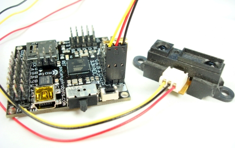

    Analog sensors, such as the Sharp IR Rangefinder should always be connected to the regulated 3.3V bus (unless they are < 3.3V sensors).
    warning: Applying more than ~2V to the ADC will cause the Rx of the wireless transmitter to stop working. Some SharpIR rangefinders will output higher than 2V, so a voltage divider must be added to the sensor output.

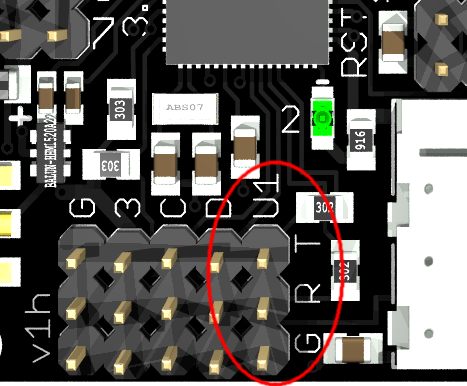

    STEP 5: Connect UART
    The UART is a way for the Axon Mote to communicate with other hardware through serial, such as a camera, bluetooth, or GPS. It's as easy as plug and play.
    T is for transmit, R is for receive, and G is for ground (make sure external devices share a common ground!).
    Axon Mote UART Connection
    There are two available hardware UART ports, but the USB uses one of them. Additional [slow] software UARTs can be created using WebbotLib.

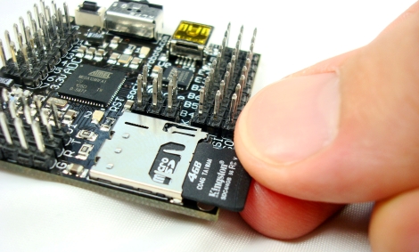

    STEP 6: Insert uSD Card
    Optionally, you can use a uSD (micro-SD) card to store various forms of data. The uSD is NOT included, nor is it required to use the Axon Mote. Any local pharmacy and RadioShack will sell uSD's, while the recommend online stores to purchase them would be [uSD cards at Amazon] and [uSD cards at NewEgg]. Your cellphone is likely to have a uSD and reader (back up your data before using it). This is the uSD I use, with a handy USB reader.

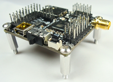

    STEP 7: Mount Axon Mote to Robot
    It is recommended to mount your Axon Mote to your robot using spacers. Here is an example with four 0.75" spacers and 4-40 screws (not included). DO NOT use a metal screw where the button is, as you might short the button pin with ground pad. Plastic screws preferred.
    Axon Mote Mounted to Robot
