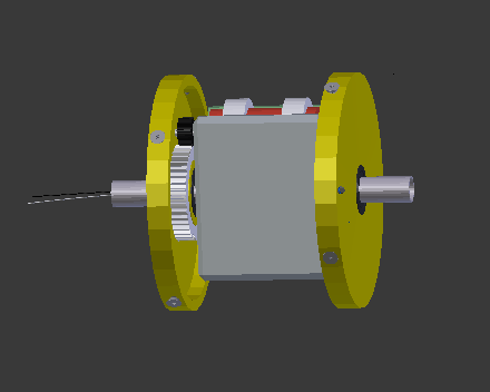

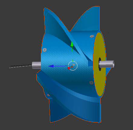

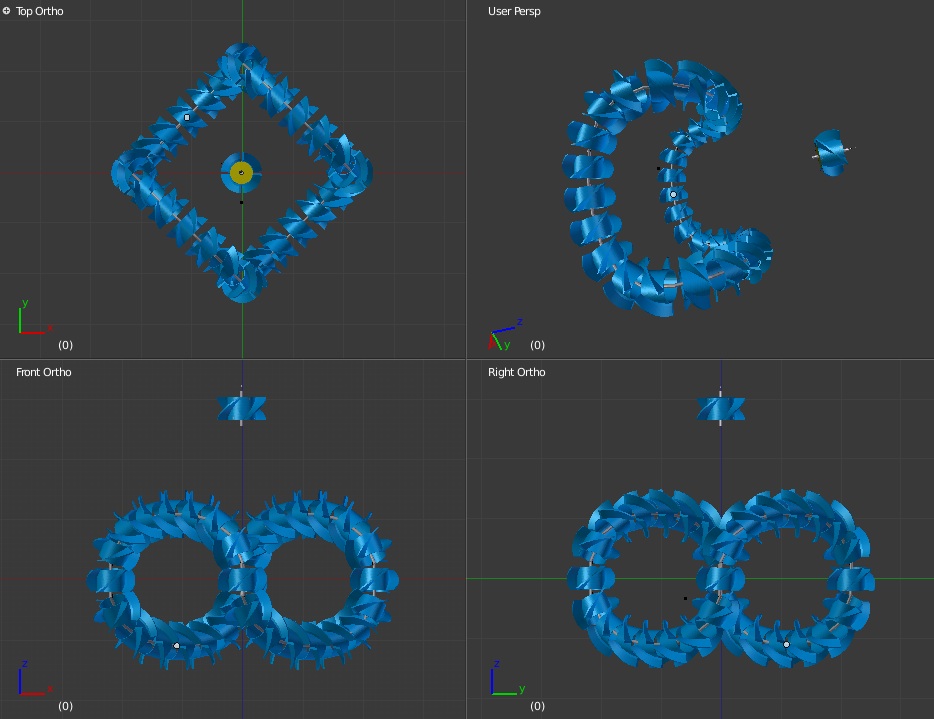

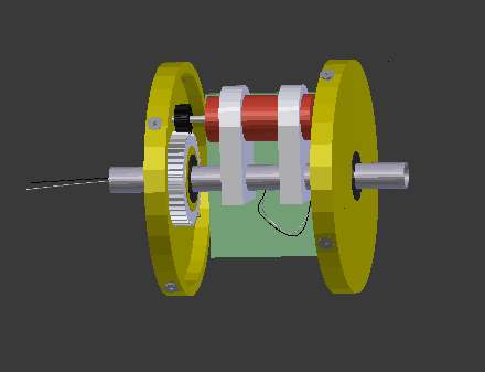

I'm building a rotational system with 32 rotors/motors that I want to try out under water. And I would like to adjust the speed of all the motors ranging from 0 to 120 RPM and do this with a RC control system. So basically I want to hook all 32 motors up to one receiver but I need some help with the electronics.
I would like to keep every thing as small as possible, therefor I thought of using a MicroFlight Transmitter/Receiver and  Solarbotics Geared Pager Motors (25:1) and 3.7v Single Cell Li-polymer Battery(s) with a Max Discharge of 15C (1350mA) (see pix) It is possible to wire several motors on to one MicroFlight receiver in parallel, as long as the total current does not exceed 3 amps or the capability of the battery. (whichever is lower)
Note, my original plan was to use gears (see design pix) but the Solarbotics motors have a transmission belt output instead of a gear, and I think this is probably safer incase some rotors touch each other etc.  The question I now have is the generated rotational speed (RPM) when using 32 motors and that one receiver.
