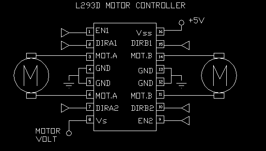

There is the pinout diagram im using.

Here are the connections i made
Pin 1- +5V
Pin 2- +5V
Pin 3- Motor
Pin 4- GND
Pin 5- GND
Pin 6- Motor
Pin 7- not connected to anything
pin 8- +5V
Pin 16- +5V
rest of the pins are not connected.
The +5V regulator works perfectly and supplies 5.03V which is measured using a multimeter.
Pins 2,7,15,10 should be supplied with a high pulse from the microcontroller to turn the motors. I connected the enable pin to +5V. Since i didnt have my controller,  I connected
pin 2 directly to +5V which i thought was essentially the same thing as providing a high signal, But nothing happened, the motor stayed still. .Then i connected pin 13 and 12 to gnd and still nothing happened?

You do need pin 7 connected.
Look at the logic table in the data sheet and ensure that none of the signals need to be low instead of high.

Pin 7 should be the opposite of pin 2, so if pin2=+5v then pin7=Gnd. Swap them over ie pin2=Gnd and pin7=5v then the motor will turn the other way. By using PWM to pin1 then you can use this to set the speed - but connect to +5v for now to say 'full speed'.
EDIT: if pin 2 and pin 7 are the same level - then it will cause the motor to brake. If you are using WebbotLib and Project Designer then add your device in Project Designer as the L293 (3 pin) - as there are 3 pins per motor - and it will do all the PWM stuff for you,

I needed to connect pin 7 to gnd :-[.
