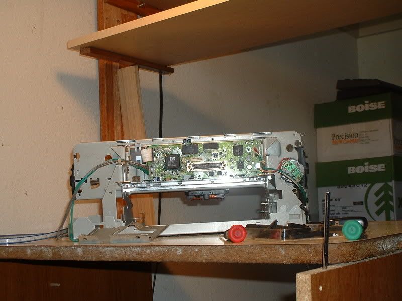

Does anyone know what these black plastic things are on the side of the printer? They have somekind of little hash marks on there for aligning something. There is one on each side of the printer head slide. They seem to be adjustable. IS this just somehting the people sue when they manifacture the device? To help them align it when it is being built.
http://img.photobucket.com/albums/v221/Dr.Gonzo1138/printer1.jpg
  • Posts: 11,585
  • Helpful? 169
Re: Inkjet printer positioning system?
« Reply #9 on: October 24, 2006, 12:21:50 PM »
uuhhhh no idea . . .
what if you poke it?
haha ok i mean does it rotate, or is it attached to anything? your theory sounds better than any of my guesses . . .

« Reply #10 on: October 24, 2006, 03:48:32 PM »
haha
Yeah, they rotate, but they don't seem to do anything when they rotate. Very strange..
