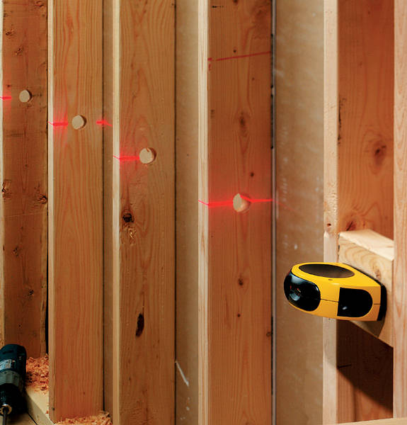

what about using the same technique as a barcode scanner?
get one of those DIY laser level things that gives you a straight line of red light. (i couldn't find a very good picture of one:http://www.tlc-direct.co.uk/Images/Products/size_3/FXLLGC.JPG)
point the laser thing a set distance ahead of the bot, drawing it's line across the robot's direction of travel.
the laser will be far brighter than any other light source so ignore all colours other than red and first look for the red laser line in your image.
once you have isolated the laser line look along it's length for variations caused by the line panted on the road.
you are using the laser to illuminate the view to such an extent as to make background light insignificant.
so i can see some disadvantages with doing things this way, notably reducing the depth of the cameras image to a single line illuminated by the laser.
maybe use multiple laser thingies.
or move the laser line in the same way supermarket checkout scanners do.
meh. maybe i'm over complicating things again.
dunk.
(with frickin' laser beams)
an interesting idea, but i dont think it will work (not entirely sure). barcodes do black on white, but the mobot course is a white paint on light grey cement. the terrain is also unlevel with cracks in the sidewalk . . .
