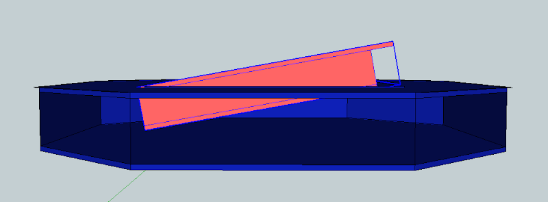

Ok guys, I'm having a bit of trouble.  I've included a few pictures to go along with this post.  First of all, the blue area in the pictures is the body of my robot, and the pink/red/light pink thing is the holder for my PDA.  I want it to hinge up so that I can easily remove my PDA if I need to, except I can't figure out the hinge.  Obviously there's going to be a gap between the holder and the body of the robot, but that isn't incorporated in my CAD drawing.  So here are the pictures.

Pic 4.
This is how I want the holder to open.  (Or something like it)  The problem is that this wouldn't be possible, as the body and holder are overlapping at the top left hand corner of the holder.
Pic 5.
Another view of holder open.  As you can see the holder's hole is easily accessible for me to remove my palm.

Yeah that's probably easier... I have one idea for that...
Attached picture.
RED=phone
GREEN=phone holder
BLACK=body
The phone holder would have a spring underneath it with some kind of spring loaded release on the top that you push over to allow the holder to pop up.

You can make a hinge similar to this:
Those types of hinges are made for the hinged flush surfaces (that hinge in the picture is for a RC airplane hatch)

the hinges razor mentioned look as if they are a good solution.

Ah ha!  I knew there were hinges like that, I just couldn't find them.  Those look like they'll be perfect.  Anyone know a good place to find them?  I did a quick mcmaster search and couldn't come up with anything.  (And by quick, I mean like a full minute...)

The link was in the picture...
http://www.hobbyking.com/hobbycity/store/uh_viewItem.asp?idProduct=8230&Product_Name=Hatch_Hinge_27x10.5mm_(10pcs) $1.49 for a 10 pack...
