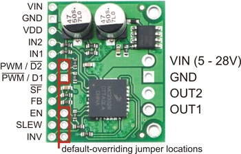

There are cheaper non-digital alternatives out there, but the trade off is that they are much more complex to integrate. They would require many more IO pins of the Arduino to be used, and would require you to build some additional support circuitry to use.
For example, This one is $23
http://www.pololu.com/catalog/product/1212
But look how many wires it needs:
And that's just for one motor.
While the Sabertooth would just be serial and ground to both.
