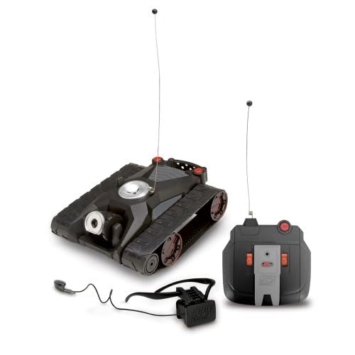

I just heard about this hackable toy in my email today (see below for quote).
components useful for hacking:
tracked robot chassis
two channel remote control and receiver
two DC motors
two motor drivers
wireless camera
wireless microphone
LCD eyepiece to see what the camera sees
I hear its marked down to $25 at Target, making it an awesome buy. Otherwise, the next cheapest place I can find it is amazon.com for $67.81 (or $43.86, "best price").
I was at Target today and noticed they have the "Spy Video ATV-360" on sale for $25 marked down from $100. This is a dual-stick radio controlled tank drive unit that carries a B&W video camera and microphone. Video and sound are radioed back to the controller to which a monitor (on glasses frames) and an earpiece are attached. Uses 6 x AA batteries in tank and in controller.
Yep I bought one. Video quality is so-so and appears to be sensistive to IR. I cracked open the tank unit and inside are a couple of fairly beefy DC motors driving reduction gear sets. Motors (with noise caps) are driven by dual H-bridges created from TO-220 devices; can't tell if they are bipolar or MOSFET. There is a separate RF transmitter for the camera with a short internal antenna. I haven't cracked open the controller yet.
All-in-all a nice unit and seems pretty hackable. Thought the group would be interested.
And, yes, I will buy another one.

The real deal right there are the LCD eyepeices. Normal video goggles go for hundreds of dollars, but those eyepeices are cheap if you can find them. After removing a resistor on the inside you can connect any normal vido signal and it will appear on the eyepeice. Really useful and cheap.
