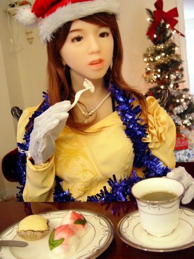

Hello everyone.
Merry Christmas and Happy New year.
Aiko V2 New faces finally reveal. The face is made of silicone as in Aiko V1.
Aiko V2 face has more facial movements, including closing the eyes, smile..etc..
Also dual cameras in the eyes. Including tear ducts and more sensors under the skin.
Any ideas to improvement on Aiko v2 or questions, please email to me.
I will try to upload the video when everything is done.
