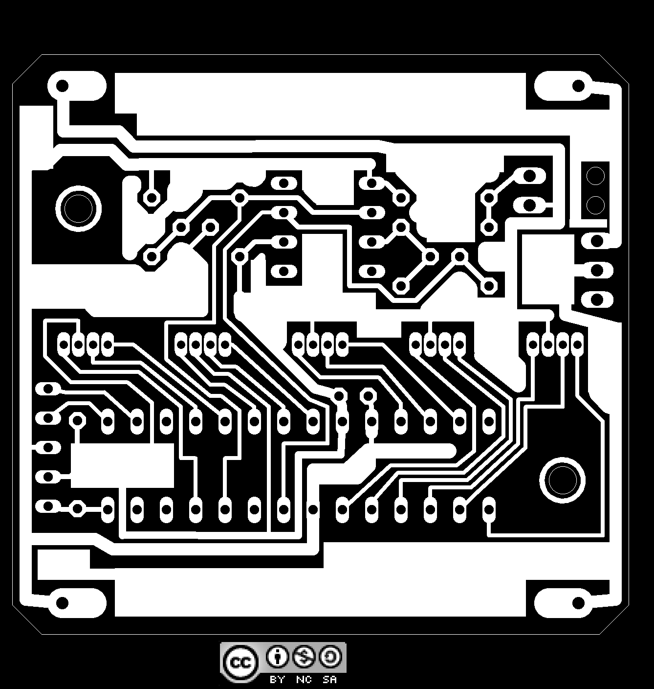

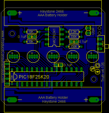

But if you DO wish to use an MCU still I found a schematic and .c files a while ago:
