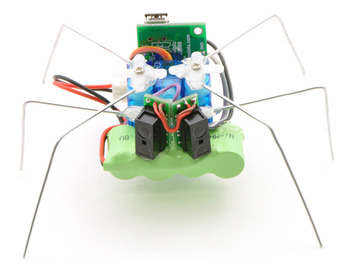

Hey all.  Paul at Pololu wrote up a guide on how to make a simple hexapod walker using three sub-micro servos, two digital distance sensors, a programmable Micro Maestro servo controller as the brains, and a lot of hot glue.  There is a video at the top of the page that shows the result.  I don't know if this is the right forum to post this in, but I wanted to share since I know there are quite a few enthusiasts here who might be interested in a project like this.

This would make a great little desk-walker/conversation piece, and it could even tap out rhythmic beats for you and your coworkers.  We'd love to hear how it turns out if you build one.
Paul has made a post on the pololu forum about the project:
With the release of the Micro Maestro USB Servo Controller, I wanted to move up to a servo-based design, but keep the number of servos to a minimum. My goal was to design a hexapod that could be built in an afternoon without any special tools beyond what I usually use for electronics, and to demonstrate how the Maestro's scripting capabilities could be used to sequence motion for an interesting, autonomous, walking robot.
By the way, here's a picture of the finished product (it's about 2 inches high):
- Ben
