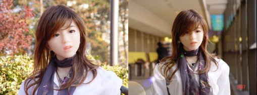

Hello everyone.
As you know there are a few female android prototypes in the market  or seen at the convention show.
However, the androids are very simple because they can't walk, and some are simply pre-recorded voice
or very simple AI.
I want to be the first to make an advance android female robot that can walk with AI that can interact with people
and the surrounding( That is my dream)
If it works GREAT, and if it does NOT work ...life goes on with a large credit card debt.
Short form spec for the android.
Pro:
Project Name: Project Aiko
Code Name: Aiko
Height: 153 cm
Weight: still adding more hardware
camera: 3 cameras with 3ccd
battery: MN-polymer
Mainboard: C7 with 8Gig solid state.
Sensors: 12 sensors (max 16)
DOF: 30
Software: Sandai (advance version)
Con:
Haven't figured out the center of gravity for large android yet..
CPU and memory intensive
Must connect to the internet to get data from our server.
(Can run without connecting to our server, but action are limited)
Aiko body was custom made from implant silicone from head to toe, therefore, it looks and feels as close as a female human.
The body is now being re-done and re-designed with our new specification to make it looks more female like with a slimmer body and lighter weight.
I am hoping to have a demo video sometimes this week.
In the mean time, I have upload the pictures.
I put the picture behind the black background, because I thought it looks better.
p.s. If you have any suggestions, please post it here or email or PM me.
Thank

Why exactly do you have a womans head on your desk? lol, it looks a bit too lifelike.... nioce job on it, so, the eyes are were the cameras are? they look real.

A question about the cameras: You cant actually get the pupils moving right? Good job thought, it looks really cool! But a robot like that is quit much money right? I mean all does servos/motors and the electrician must cost a little to. And if i dident read to fast through it you got the "skin" special made from Japan?
One last question  :P Who's "we"? You kept on saying "we". Some kind of buddys u have been working with or other engineers teaming together?

Ai-bot you clearly have great skill so don't take this as an insult but -
Am I the only one who finds this thing a little creepy?

« Reply #12 on: June 19, 2007, 03:00:05 PM »
"Am I the only one who finds this thing a little creepy?"
Yes, at night time !!!!
When I walk around at night and Aiko sees me... it will say "hello master"
It scare the heck out of me.
Sometimes when I sleeping.... I hear Aiko talking...  sound like a ghost talking, then I remember it was only Aiko.
Before what I do is... have Aiko login to online chat  and chat with other people (interact with other people).
(This is how Aiko learn how to speech... build up her volcabury and sentences) I still have to double check the next day.
(she has the brain of a 10 years old... nothing fancy.)
Now I just turn Aiko OFF when I go to sleep....because it start to get scary.
Now I only turn her ON when I go to work in the morning.... have her interact with the surround including my two dogs.
"Who's "we"?
There is NO such thing as "we" only  I, me  and myself.
When I was younger my english teacher told me that it is more polite to use "we" instead "I".
So now when I write I use "we"
This is the download fall..... camera and eyes.
Aiko has two eyes obviously...
Only one eye has the camera, the other eye is fake.
Why...... because I am running low on money. So she only has one real eye.
It is a Matsushita lens with 3ccd.
 ( the software can handle 9 camera)
But aiko only has a total of three camera.
1 in head
1 in chest
1 in hand/arm.
The project naming and meaning.
Overall Project Name
SANDAI: System automation network diverse artificial intelligence
Software running Name
BRAINS: Bio Robot Artificial Intelligence Neural System
Hardware (Android Name)
Aiko: "Love child"   japanese meaning for aiko name.
I hope that clear some of the questions you may have.

Offline Ai-botTopic starter
  • Posts: 94
Re: My Female Android Robot Project Update.
« Reply #22 on: June 20, 2007, 01:34:17 PM »
Hi
Yes, Aiko has some learning capacity.
Example.
This is Mike.
Aiko how old is Mike.
Aiko replay: I don:t know.
Aiko Mike is 47 years old.
Akiko replay: Mike is 47 years old.
It has its own internal memory to keep track new data for learning capacity.
The download fall, is that Aiko only has 8Gig internal memory.
After the OS and the software, Aiko only has 1 Gig of internal memory for learning.
Which is not much.
  • Posts: 94
« Reply #23 on: June 21, 2007, 11:30:28 AM »
"A question about the cameras: You cant actually get the pupils moving right?"
No the pupils does NOT move.
Also the eyes does not move, because the camera is there.
I could make the eye blink, but that would cost more money.
Therefore, I only make the upper lips and lower lips move. Also the jaws move.
Right now I am more concerned on the AI and the center of gravity.
I actually, did the video recording yesterday. Just need to edit it, to make the video shorter and compress it.
  • Posts: 94
« Reply #29 on: June 22, 2007, 07:28:24 AM »
"How much would a voice recognision cost?"
Not too sure what you mean, but the cost is hardware and the software to run it.
Software is free because I do the programming, but if I didn:t know how to program it, I would have
to hire someone who can convert 3-d images to 2-d.... it will cost alot of money.
The color, face, object, speech, reading etc... I have to program it.. No one is going to do for you.
(I may release as open source or SDK in the future, but that it the least of my worry right now)
Hardware.
You will need a good camera and microphone.
I started off using webcam with build in microphone..... it was crap.
Then I borrow my father SONY camera with 3ccd....it cost about $4500 .... it was old model, but it makes a lot of difference in quality.
It makes my life a lot easier to program software to convert 3-d to 2-d with a good camera.
After that I went out and look for a decent camera with 3ccd...
The cheapest and big bang for your dollar was a Matsushita camera with 3ccd... cost about $850 each.
After you take it apart, it only weight about 150g so not that bad.
(The original weight is about 650g)
Then I went out and get myself a good microphone, which cost about $200.
So the cost is 850+200 + tax
(This is miniumn cost)
But for my project Aiko, I bought three camera so just multiply by 3X.
So the answer to your questions.
The hardware is the cost.
For me it was the Matsushita camera and microphone
Personal, I think one of the most important sensor in a android/robot is the eye (camera).
Just like human, our eyes is #1 sensor and #2 is our hearing.
That is why I spend a lot of money on camera (eye) and microphone (hearing)
