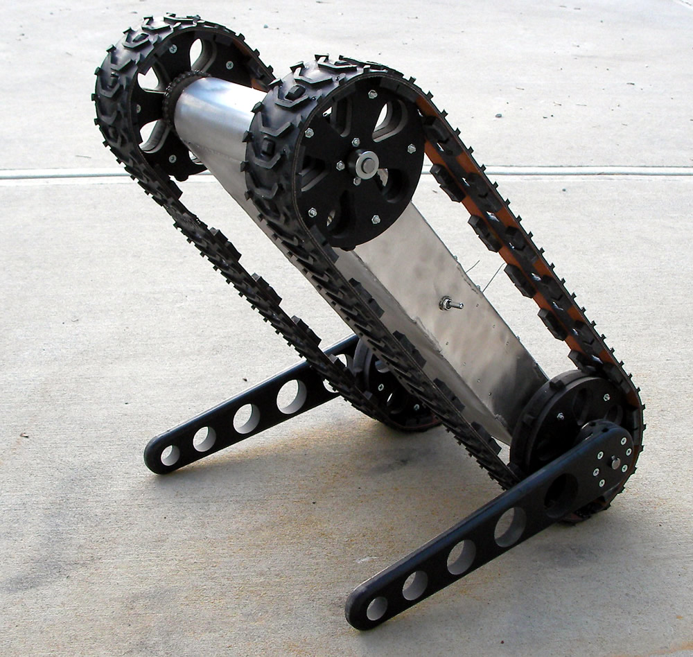

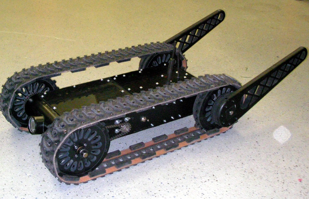

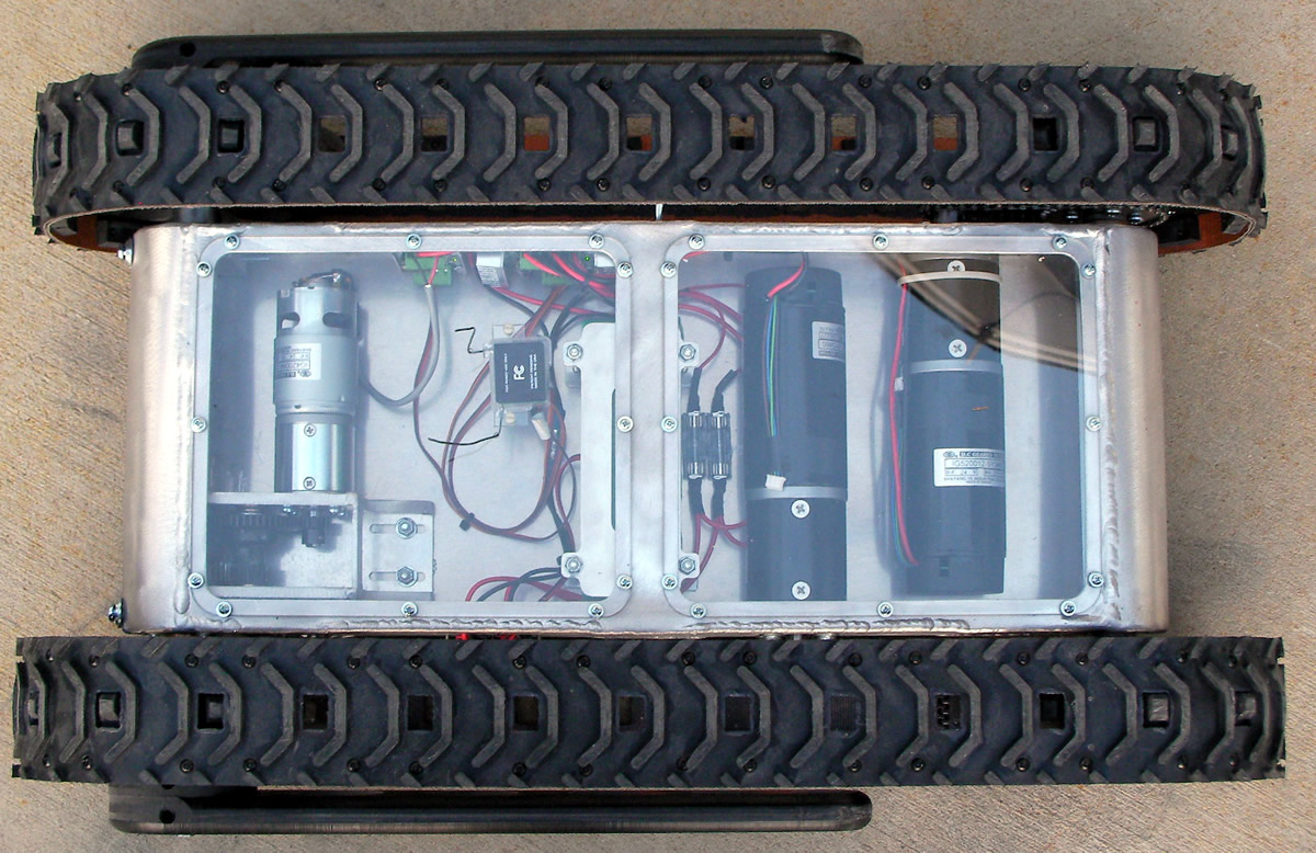

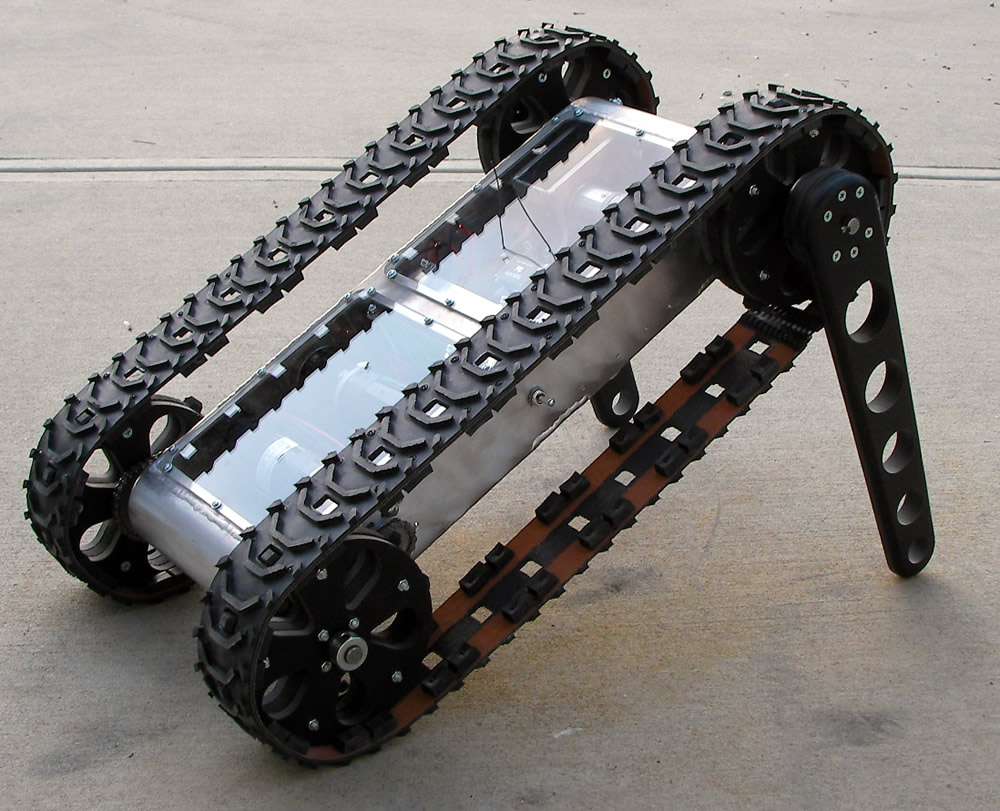

Total you need three motors, two will drive the tracks, another drive the flipper arm.
http://www.superdroidrobots.com/LT.aspx
