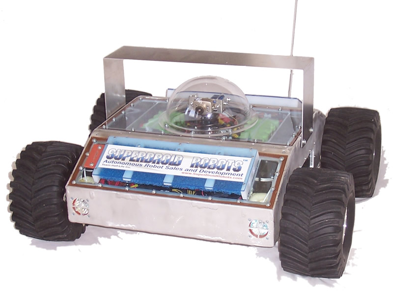

i am planning on making a nock off off this
http://www.superdroidrobots.com/pictures/ATR/Deluxe.jpg
