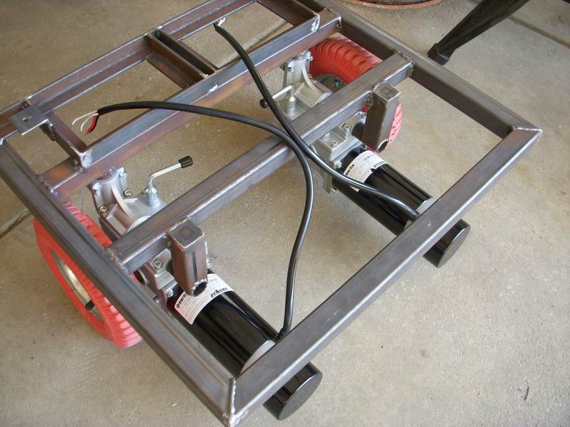

I just built a robot with wheelchair motors very similar to yours.
The thin wires are to release the brake.  Just apply 24VDC to them and the brake will release.  Make sure you energize (release) the brake before you try to run the motor.  In my robot, I just have the E-stop circuit disengage the brake since I don't need it for normal operation.
The handle you see is a manual transmission engage/disengage lever.  Turn it one way to engage the motor and brake, turn it 90 degrees and the output shaft will free spin.  I wouldn't remove them if you don't have to.  They are very handy for wheeling the robot around in the shop.

So, I must continuously apply 24v to the brake wires to make it release/go, with the thicker wires, or just to operate freely (by hand) without any extra voltage.
Also what controller did you use? As that would help my search very much.
BTW, I was referring to any thin wires coming from the motor case, not the encoder case.  Thin wires coming from the encoder are encoder wires, not brake wires.
Given that - Yes, if they are brake wires, you continuously apply 24V to release the brake (to the thin wires).  The thick wires are, of course, your motor armature leads.
I'm using the Dimension Engineering Sabertooth 2X25 drive to drive them.  I control them with a PIC micro.

« Reply #20 on: February 02, 2009, 04:22:33 PM »
I am worried about mounting the Motors, are they to be mounted vertically? For example:
Three pieces of wood in a U formation and the motors mounted on each side. Because they can't be mounted underneath. Also can one screw/screw hole support all this weight? Here is a picture:
http://i99.photobucket.com/albums/l303/_Corrupt_/SDC10388.jpg
If this is my best bet I know L Brackets are necessary, but what else?
Edit: I have already consulted Airman's Butler robot tutorial, his motors have multiple screw holes, and at the bottom, to be mounted horizontally

As requested...  The mounting of my wheelchair motors.
The motors came with hardware to mount them to 1" tubing (ala wheelchair frame), so I did that.
« Last Edit: February 15, 2009, 06:15:56 PM by ArcMan »

Offline ArcMan
  • Posts: 519
  • Mmmm... Plasma
Re: My Butler Robot: Wheelchair Motors
« Reply #29 on: February 15, 2009, 10:04:25 PM »
Thanks.  Problem is, it has too little ground clearance.  So I'm going to re-do the frame to mount them vertically and switch to 10" diameter knobby tires.
