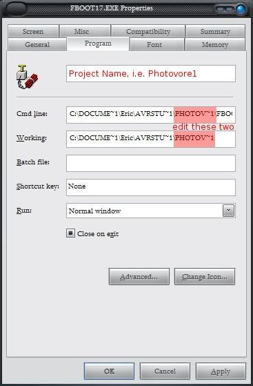

Here's a screenshot of the properties window that I use for my Photovore's code updates:
To properly set this up, go to the properties of the shortcut.  In the General tab, the only thing of note is the shortcut's name, next to the icon. In my case, I put Photovore1.
Then in the Program tab:
The space next to the icon can be left blank. If you put something here, it will be the title of the cmd.exe window that opens when the shortcut is clicked.  (in this case, I again use Photovore1)
"Cmd line:" has a full entry of:
C:\DOCUME~1\Eric\AVRSTU~1\PHOTOV~1\FBOOT17.EXE -b115200 -c2 -pAxon.hex -vAxon.hex
And "Working:" has:
With this setup, it should work right off. Just make sure the COM port is connected. (in my case, COM2, or -c2)
For other programs, you can simply copy the shortcut and edit the properties.  The only parts you need to change are the names, and the project folder (highlighted in red in screenshot).

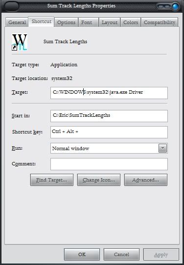

This second screenshot is the one that I had set up for a java program.  The shortcut properties window is different, despite the fact that in both cases, my computer has been Windows XP Pro.  I'm able to get this one again if I use a .exe in the system32 folder. *shrug*
If your properties window looks like this, just modify Target and Start-in to have the same contents as "Cmd line" and "Working", respectively.

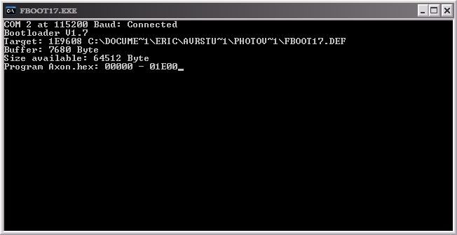

And this is what it looks like while running.  After it finishes, the cmd.exe window closes. You just have to open the shortcut again to do it again.
