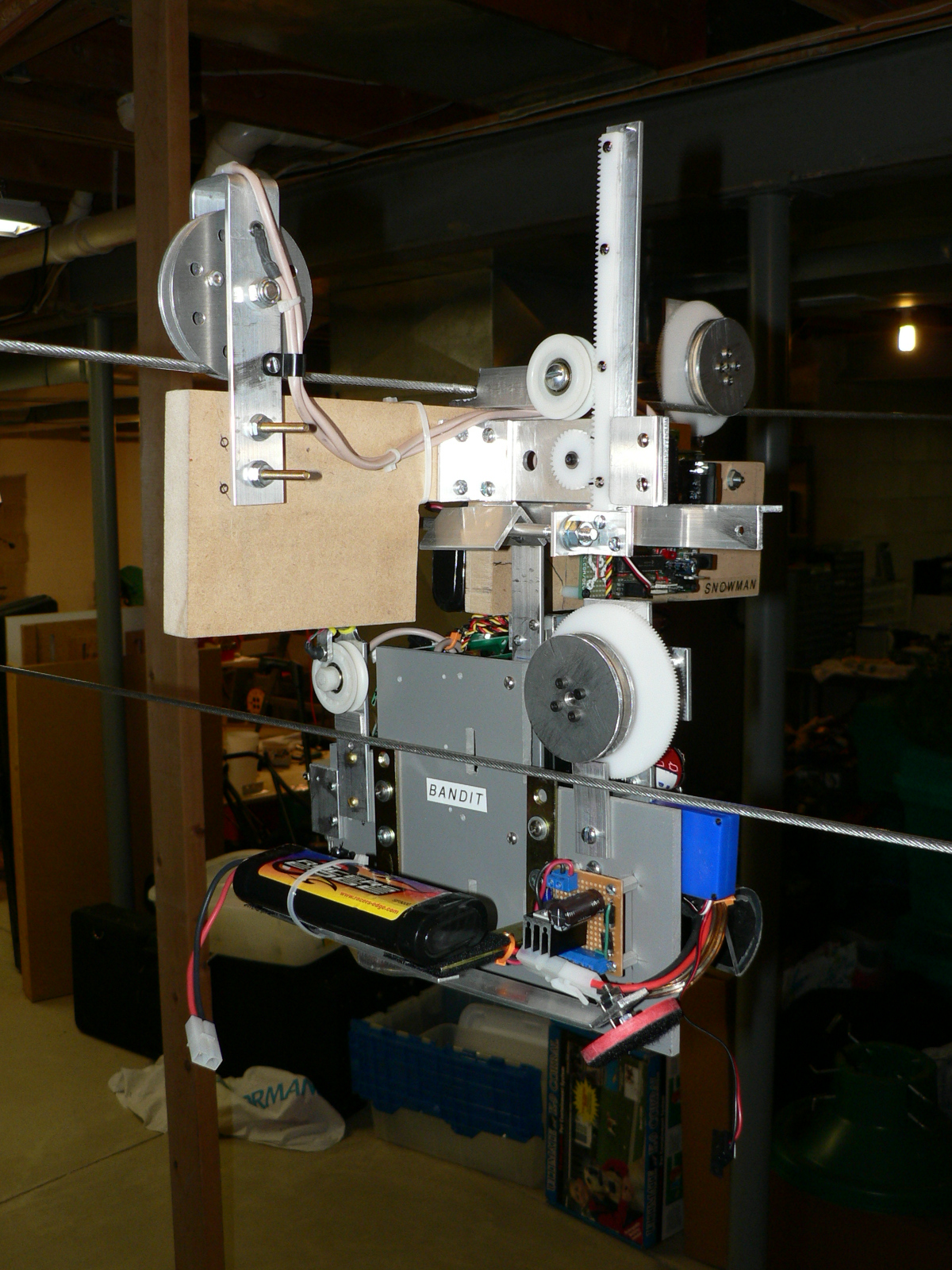

The 6mm expanded PVC is quite rigid.  Here's a shot of a high-wire challenge robot we made.  The bottom bot uses it.  It's easy to cut, machine, drill & tap.  I've also used aluminum threaded inserts with great success.
