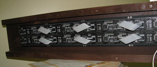

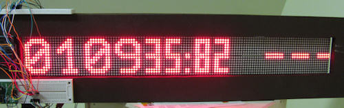

for 16x256 LED display you can use this 16 number of "0832 LED Dot Matrix Red Display Information Board" arrange in 2X8
Picture is in 2X4
http://cgi.ebay.com/0832-LED-Dot-Matrix-Red-Display-Information-Board_W0QQitemZ250569862375QQcmdZViewItemQQptZLH_DefaultDomain_0?hash=item3a5720ace7#ht_2518wt_1165
http://www.sure-electronics.net/download/down.php?name=DE-DP104_Ver1.0_EN.pdf

That Driver board only drive 2x4, but it can interface with PC computer to display messges.
You can check this out, this is using standard PC PS2 keyboard interface with AVR uC.
http://www.arduino.cc/playground/Main/PS2Keyboard
http://www.arduino.cc/playground/Main/PS2KeyboardExt
