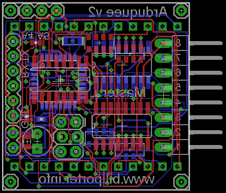

Man, after maybe 10 hours of Eagle layout, I managed to get all the components of the master to fit behind the small matrix.
Definitely the hardest design I have done yet. The only problem is I could only break out ADC4 and ADC5, besides the 6 pin programming port and Arduino FDTI port, which has the Uart. I figured ADC4,5 where the most useful to breakout if I could only pick two, as they can be digital IO, analog, or I2C bus. There's also the three digital IO you could get from the 6 pin programming port as well.
Thoughts?
Offline Ro-Bot-X
  • Posts: 1,431
  • Helpful? 25
  • Store: RoBotXDesigns.ca
    • Ro-Bot-X Designs
Re: Arduquee, a Arduino powered Marquee
« Reply #3 on: September 08, 2010, 05:18:49 AM »
It's perfect! You're the Man!

Offline madsci1016Topic starter
« Reply #4 on: September 08, 2010, 03:52:20 PM »
Hehe, thanks.
I spent about 4 hours cleaning up the design and fixing some dumb decisions by the auto-router. I'm getting ready to send it off to a PCB fab house unless anyone has any other thoughts?

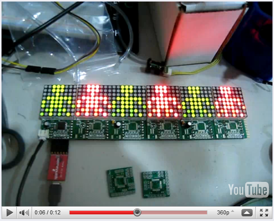

I severely underestimated how much noise was going to be on the power lines from all the switching going on, I had to add caps to every slave board to help keep it under control.
But it's working well, have a look...
Arduquee, a Arduino powered Marquee; first words

This should cause some chuckles. My first attempts at animation. I was trying to make it so they looked like they were walking, but instead I think I created the first SOR line dancers. I'm no good at this creating animations thing.
(There's an audio swap pending for some matching dance music. Youtube is slow)
Society of Robots Line Dancers
You might not find this amusing as I do, but I'm hoped up on steroids, antibiotics and a handful of other medications with a fever of 101; I think it's funny.

Seriously though, thats looking really good!
I even found something kool in your animation:  Pause the video at around 5-6 seconds... the resulting image of the led's begin turned off and on and being caught in the same frame by your camera produces what looks to be a space-invaders style mother ship of some sorts...or a StarCraft II Battlecruiser... ;D
« Reply #20 on: September 22, 2010, 06:12:21 PM »
I assume you mean this frame:
hehe, cool.
