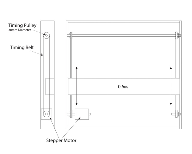

Hi There
I was wondering if someone can help I am try to work out what Stepper to buy, I am trying to build a vertical scanner but i am building out of wood so it has to left quite a heavyish and there quite a bit of friction. so i was wondering if there's any calculation i can use try and work whats best, also is there a tool out there i could use that would how much force was needed as i guess wood friction is quite hard to calculate
Here my plan
Any help on this would be greatly appreciated
James

« Reply #5 on: October 19, 2010, 10:34:42 PM »
From your diagram the object you wish to lift is 0.6Kgs , normal force = mg ( mass x gravity ) = 0.6 x 9.8 = 5.88N . this is the force needed to move the object.  The torque needed from the motor will depend on the radius of your motor pulley, for example if you have a pulley that is 30mm in diameter you simply multiply the force needed (5.88N) by the radius of the pulley in meters (0.015m)   5.88 x 0.025 =0.0882 N.M  .
The friction force created by the wood is hard to calculate from the little information you have given
 the true friction coefficient could be very high so  I would recommend bearings and ceramic bearings really are not that heavy .
This is just a simple explanation but it should help
« Last Edit: October 20, 2010, 06:10:51 AM by photomark »

« Reply #6 on: October 20, 2010, 08:51:31 AM »
No, overcoming the friction is only part of the force to overcome.
Sorry, my bad - I somehow got into my head that the "drum" (or whatever) should rotate in place. Well, scanners can be do many different things, now I see it's more like a flatbed scanner raised on an edge.
Sorry.
And yes... Plus one to the counterweight, now that I've finally got the idea  ;D
