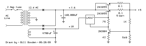

http://www.eleccircuit.com/high-current-regulated-supply-by-lm317/
This is the "pass transistor" that waltr talking about
But I don't think you can use LM317 to make your own power supply for your robot, you can get one of this
