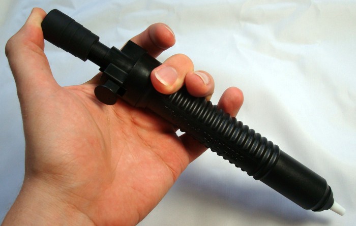

My biggest issue with this model is the size – it’s clearly for industrial use. I typically only need it for rare occasions and for small electronics, so I’d probably want a smaller version of it. On my older el-cheapo solder sucker, you can operate it entirely with one hand, using the thumb to lock the spring. On this guy it requires either two hands, or pushing the spring loader into something like your leg or table to reload. This will take a while to get used to if you’ve used only the el-cheapo brands all your life.

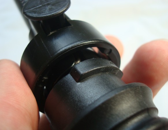

On my el-cheapo solder sucker, it would gunk up all the time as the spring is located in the air chamber. It was also very frustrating to open up, with a messy 10 minute disassemble-clean-reassemble process. On this Weller, it has an easy access feature where you can open it up in about 1 second, shake/scrape the solder out in under 10 seconds, and reassemble in about 2 seconds. But as it’s industrial size, and the spring isn’t located in the air chamber, it’ll be a long time before you even need to empty/clean it out.

On a serious note, good review.  It does seem huge (or you have tiny hands).  I'm sure it really sucks though (in a good way).

True, it does look pretty sizable... again industrial.
