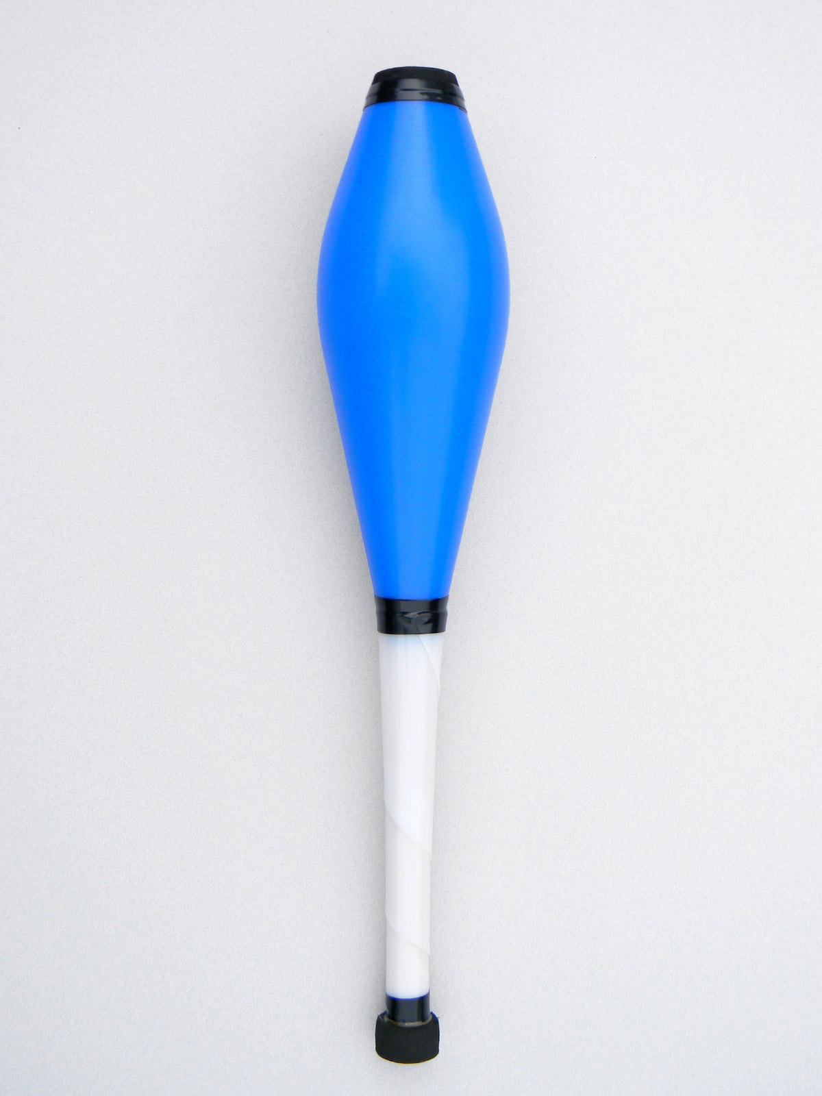

I'm trying to make a juggling club that looks like a regular juggling club, but has moving parts inside of it such that the moment of inertia changes randomly making it extremely difficult to juggle.  I was thinking that I would use some sort of linear actuator for the dowel that would move the weight back and forth between the center of the club and the end of the club.  The problem is that the linear actuator would need to small enough to fit inside of the club, strong enough to be a structural part of the club and be able to withstand dropping on the ground etc, and would also need to be fast.  Accuracy is not needed at all.  I would even be fine with pulling the weight on a spring and then letting it go or something like that.  The power source would also have to fit inside the club.
Here is an example of what the club would look like.  This club has a wooden dowel inside that runs the length of the club from top to bottom.  I would probably be replacing the wooden dowel with something that would be able to move the weight around and also replace the function of the dowel.
