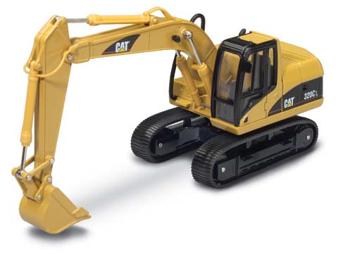

It will be incredibly difficult to mount servos on this:
Did you think about adding the servos to make the tracks move? How on earth are you going to connect the servos? Also, if you make it a r/c excavator your servos will add weight to the shovel and you will need a really strong servo to support the rest of the servo ( kinda like a robot arm)
Those servos you posted are fine, but then again :  How the heck are you gonna mount the servos and make the servos move the tracks???

maybe he could mount the servos on the main body and use a tendon like mechanism to power it
IDk how he's gonna do the propulsion though

I wanted to put servos with like those rubber things to pull the arm from the main body. To drive the treads, I hope that the top is removable and then I'll add the servos and put the top back on.

Ok I trashed the whole excavator crap. I didn't think of how hard it would be to mount the servos.

And, do you guys know where to get a robotic arm with a shovel on the end? Kinda like an excavator. Or should I make it myself? If I do, the only thing I don't know is how to make the joints movable if you know what I mean. Like if I just put screws in it's going to be tight and inefficient. Is there a special way to do it.

my little bro has a sheet metal excavator with rods instead of tendons actually it's flat metal not rods, but oyu get the point)
you want a pic of it?
Sure, if it's not a problem for you. Because I didn't really get what you were talking about. Thanks!

heres what I took this morning.
hope it help
if you want bigger pics click on it. if you sill feeling greedy let me know  :D
that thing is a trooper. it's been driven over by a 4ton bobcat and only the roof bent

Thanks for the pics! That helped. Where did you get it though?
