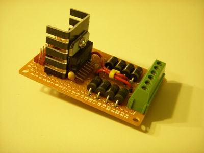

I am thinking about playing around with the L298. Would it be possible for someone who is using one to post a picture. I just want to get a visual. I have looked it up and read a lot about it already. I would like to see how someone here set it up. Nothing technical just a picture.

Yea I checked it out. I was just wondering if someone could post a picture of how they have it used. Nothing technical just a photograph.

Here ya go...

« Reply #8 on: September 10, 2008, 05:43:34 PM »
Oh BTW...
You can add the flyback suppression diodes now or wait until you blow up a couple of L298's first.
Here's the principle...
When you are applying voltage to a motor coil and then you cut off that voltage (which is what a motor drive does), the coil can literally generate thousands of volts.  This is alot of voltage.  You can either supress it to your power rails, which is what the diodes do, or you can use that energy to destroy your L298.  You choose  ;)

The pinouts are a bit of a swine with a 0.1" board - but are long enough that you can bend them to fit without a problem

Nice! Thanks for the picture. This helps me a lot.

I dont really have space for 8 diodes per motor so I dont have those either.
Look around for Diode Array IC's . . . basically a chip with multiple diodes in it for compact goodness :P

Good advice.  Just make sure the diodes are "fast recovery" diodes.
