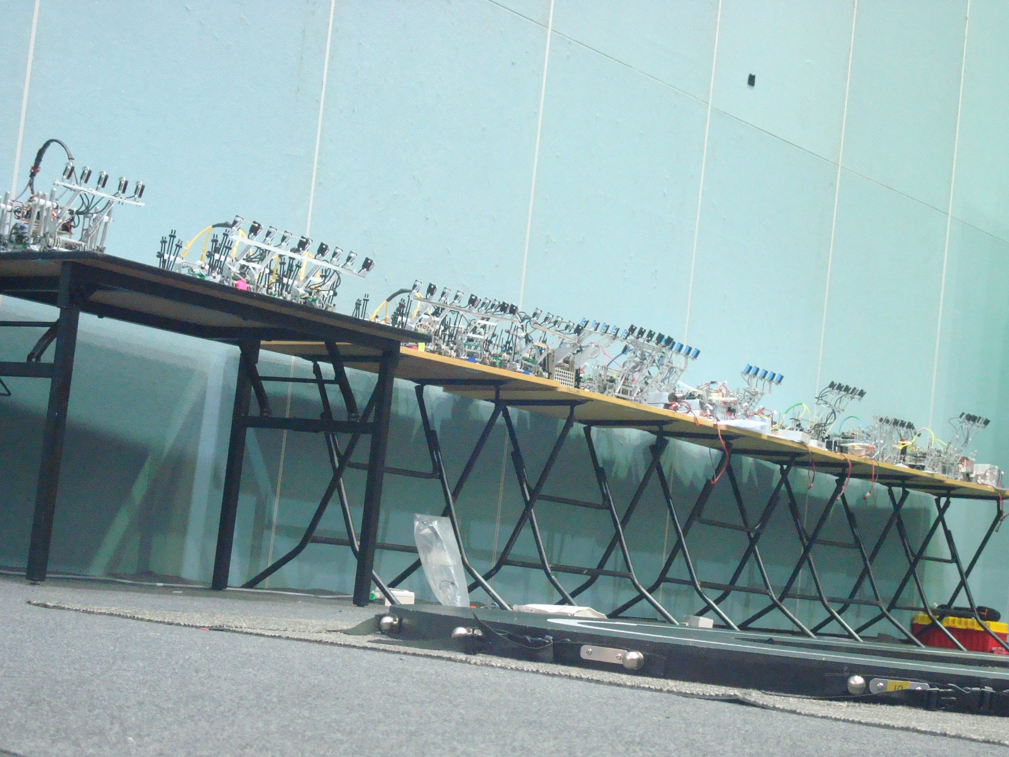

There are four sides that had a set of cams. Each side had four cams, evening spaced at 90 degrees from each other. There were like 10 teams, yet they all had the same basic design . . . but each were a little different here and there.
They called it a 'legged marathon race' . . . but I refuse to call a rotating cam a leg . . .
The only group that left their bot out in public got mad at me when I tried to take a close-up pic . . . so this is the best pic I got . . . you'll need to zoom in.
http://www.societyofrobots.com/images2/robot_marathon_race.JPG

« Reply #2 on: February 04, 2009, 11:14:40 PM »
Seems i still can make out the legs still. However thanks for the info. Ya it seems the kids at these events in asia seem very protective and the websites have very little info on the robots in general. Be it this compitition or others.
