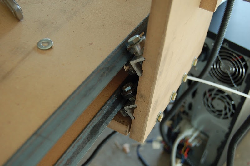

Torsion box bed.  The X-axis has dual rails to accommodate this.  Also I suppose it adds stability to the gantry:
http://lh5.ggpht.com/_KKSMATVGPec/SWVCcBSrMxI/AAAAAAAABL0/sm3Sdw1n1WM/s800/DSC_0269.JPG
Linear bearings nested in the MDF. This is kind of an older shot.  The z-axis lead screw in this picture is not 3/8 acme.
http://lh6.ggpht.com/_KKSMATVGPec/SWVCQW1jDcI/AAAAAAAABK8/RwHweY4eap4/s800/DSC_0262.JPG
http://lh4.ggpht.com/_KKSMATVGPec/SWVCSHvy6QI/AAAAAAAABLE/45om_1RrGc4/s800/DSC_0263.JPG

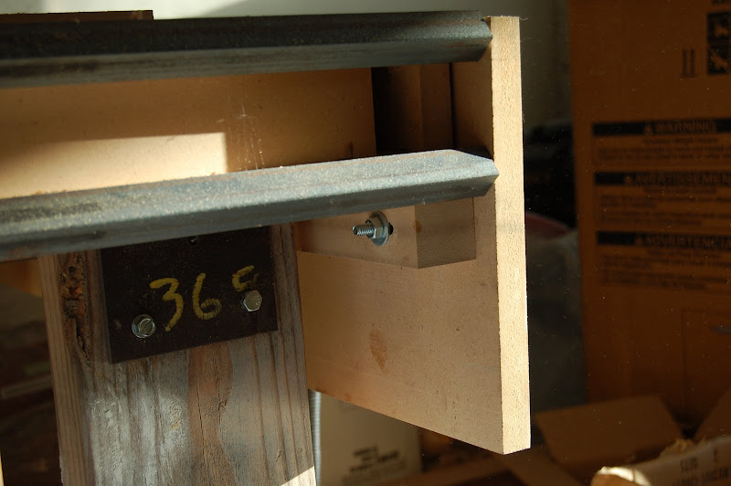

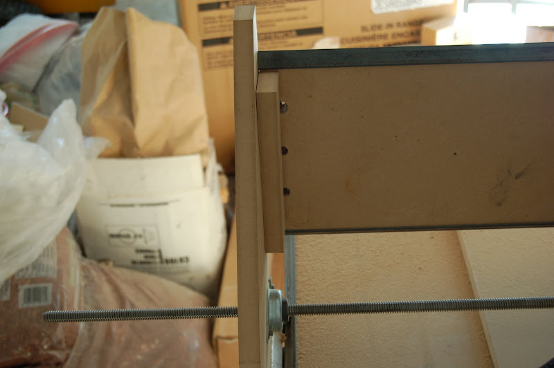

And here's some upgrades since I took that shot:
The heavy bosch router puts alot of weight on the front of the gantry, causing the y-axis rail support board to want to twist, so I added some bracing pieces here.  Also pictured is a new y-axis leadscrew (the old one was bent... you would not believe the amount of headaches that caused before I was able to diagnose it) and new, flanged bearings with setscrews.
http://lh4.ggpht.com/_KKSMATVGPec/SdJhEPANpyI/AAAAAAAABWo/FUHJZ5jUkY0/s800/DSC_0276.JPG
http://lh5.ggpht.com/_KKSMATVGPec/SdJhF9n3_0I/AAAAAAAABWw/F7k1uOiVhjw/s800/DSC_0277.JPG
The x-axis bearing support boards I made adjustable, too.  The board is vertically and the MDF flange on the bottom of the table is slotted horizontally.  In retrospect, I should have just used more flange bearings, for adjustment.
http://lh3.ggpht.com/_KKSMATVGPec/SdJhGsgS-hI/AAAAAAAABW4/Vst9aSvu7m4/s800/DSC_0278.JPG
http://lh5.ggpht.com/_KKSMATVGPec/SdJhHh9MlFI/AAAAAAAABXA/OKNjrW4LKqk/s800/DSC_0279.JPG

« Reply #29 on: May 30, 2009, 05:04:29 AM »
pic, really need to get this guy set up somewhere :P
