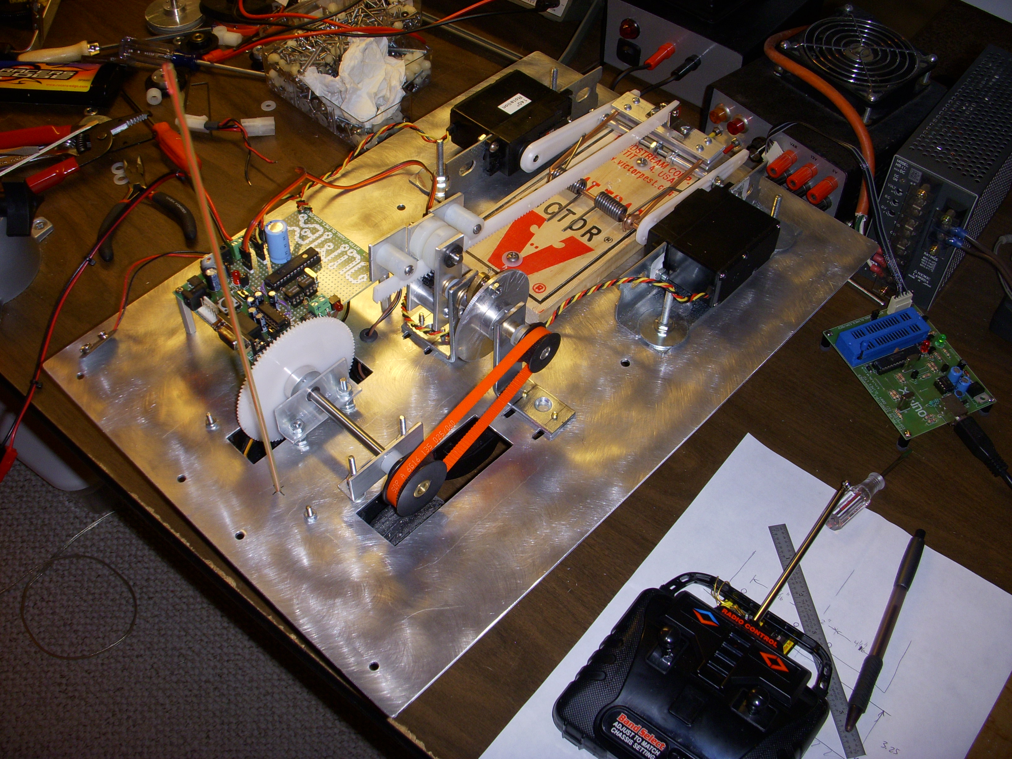

Some larger bearings (like for a 1/2" shaft) have set screws to hold the axle in place, but most small bearings don't.
So, as you said, I use shaft collars (or hubs or gears, etc.) to hold the shaft in place.  I put nylon bushings between the shaft collars and the bearings/bushings to avoid wear.
Here is a picture of a little contraption I made for a robot contest.  Look closely for the white nylon bushings.
http://www.bennetwilliams.com/img/robots/DSCN0429.jpg
« Last Edit: October 21, 2009, 07:37:42 PM by ArcMan »
ahh, not to get sidetracked, but what does the mouse trap do?
